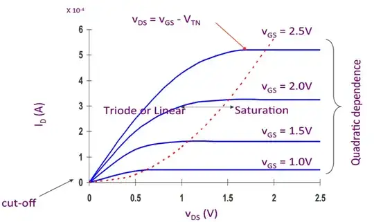

Short channel effects arise when the channel length (the distance between the source and drain of a mosfet), is of a similar order of magnitude to the depletion layer (the area between a p type and n type material that has no charge carriers). This causes it to behave differently to long channel devices. One of the main differences is that short channel devices have an early saturation current.
In a long channel device, the saturation current has a quadratic dependence with the gate-source voltage. What does this mean? Well, for a given gate-source voltage the drain-source current will increase with drain-source voltage, but only up to a certain point. After a certain point the drain-source current will stop increasing as you increase drain-source voltage, this is because the inversion channel connecting the drain and source "pinches off" due to the electric field between the gate and source. You could assume that at this point the drain-source current should be zero, but When the electrons reach the pinch off point they are injected in the depleted region and travels to the drain. Anyway, as you increase the gate-source voltage, the point at which the saturation occurs is at a higher current, and the relationship between the saturation current and the gate-source voltage is quadratic.

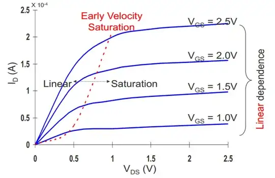

In short channel devices the saturation current has a linear dependence with gate-source voltage.
This is because the current saturates prematurely mainly due to velocity saturation. This is happens because the velocity of the carriers (and therefore the current) tends to saturate due to scattering effects (collisions suffered by the carriers).
