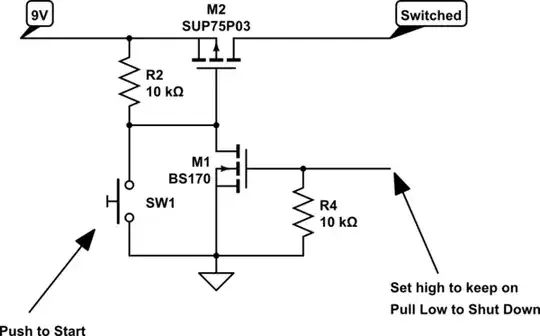

If you use a P-channel MOSFET to switch power, and use a button to turn on a timer, which, when done, releases the gate of the P-channel (pull it up to power-in with a resistor,) you will have a circuit that draws no current when off (well, maybe a microamp or two.)
I'd solve this by a small MCU like an ATTINY-85, but it could likely also be done with a 555 in one-shot mode.
schematic
For a small-current circuit, a cheaper P-channel MOSFET than the SUP75P03 can be used -- something like a BS250 might even be sufficient if current draw is < 100 mA or so.

  • That look very nice to me, but since I don't have a lot of knowledge in electronic I juste want to be sure, is this circuit usable in this current state? – Etienne Lepage-Lepitre Apr 22 '14 at 02:58
  • Yes, this circuit is usable in current state. Just add your 555 or MCU or whatever to the output, in one-shot mode, where it pulls the given gate low when the time's up. There are alternative placements of SW1 that may be safer if the gate is driven straight by a 555 output -- I updated the diagram to consider this. – Jon Watte Apr 23 '14 at 15:32
