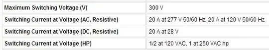

As an example of relay ratings, look at this one from Schneider Electric. (You'll want to choose your own, tailored to your motor power ratings, etc...)
In the specifications, they show different ratings:
ratings
In this case, the one that you're interested in is the Horsepower rating. This relay can safely switch current to a 1-HP motor at 250VAC (or 0.5-HP at 120VAC).
