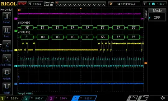

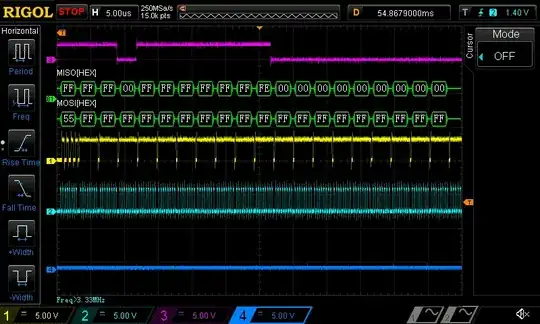

I'm sure it's not a problem with my program sending the wrong command, as I have everything hooked up to a scope, and everything seems to be correct. Here are the screenshots:
Here is the read sequence I am sending Here is the read command sequence I am sending
And immediately following, the response I get And immediately following, the response I get

  • Is the blue line labled "4" your CS? There should be no spikes on it. – Turbo J Apr 15 '14 at 17:37
  • Yes, line 4 is CS, but to my understanding, this should not be an issue. I am using a modified SD SPI driver supplied by Microchip, and those assertions and de-assertions are present in all previous commands that have worked. I will modify the code and try running with CS low and see if that helps. – farraman Apr 15 '14 at 17:43
    Nice screenshots. What model scope is it? – tcrosley Apr 15 '14 at 18:25
  • It's a RIGOL DS1104Z o-scope, got a lot of features, the most helpful being able to save screens and data to my computer.
    @TurboJ - Right after I couldn't edit my last comment, I realize you were talking more about the spikes on the CS line. This is due to not having 4 probes, and using really sketchy wires to capture. Changing over to a good probe shows no spikes.
    – farraman Apr 15 '14 at 18:27

    The read exchange looks fine to me. Since it is reading all zeros (and you have checked it is actually incorrect), perhaps you should scratch the assumption that everything before it is correct, and post it as well. – apalopohapa Apr 15 '14 at 19:45

    Can you post the relevant parts of the schematic? Are you powering the SD card with 2V7..3V6 ? – apalopohapa Apr 16 '14 at 01:09
    The registers in the SD card can be more tolerant to voltage drops than actual memory access, so this could be a power issue, perhaps you can check with your scope that the voltage supply to the card stays within 2.7 to 3.6 V the whole time. – apalopohapa Apr 16 '14 at 01:17
    @apalopohapa Success, Looking at the input voltage, it was fine up until the ACMD41 init, then dropped down to 2. My boss pointed out a diode on a different page of the schematic that should have been tied low. Now I am reading everything correctly, and can continue.
    I'm just frustrated because time and time again I've had to tell myself to check power when having problems, and I can't just assume it's not an issue because it works half the time. I appreciate all your guys' help.

The blue "4" line looks like an "automatic" CS signal generated by the SPI peripherial. This will not work reliably with the SD card, as these require the CS line to be low (=selected) during the entire read command sequence.
But the automatic CS will turn high in case something like an interrupt delays the re-filling of the SPI output register with a new value - causing the card to abort the command.
Operating the CS line manually using a GPIO port avoids this problem.

    As I just commented above, and in the content edit, this has proven no significance in the read command, but I have taken your advice and removed the spikes by asserting the CS manually. Will change the screenshots soon. – farraman Apr 15 '14 at 18:33
