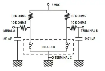

I've got a funny problem with interrupts and PWM signals that's causing false interrupts to trigger. What exactly is happening is that I'm using a hardware debounced quadrature rotary encoder. The pulses from the encoder are connected to interrupts which then I can determine the direction of rotation. Pretty standard routine. This works fine on it's own. Debounced Rotary Encoder

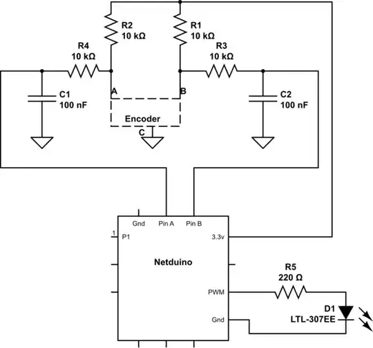

Actual Circuit: Actual Circuit

  • What exactly are we seeing in your diagram? I'm assuming: A and B are connected to your input pins, C is connected to ground? – John U Apr 14 '14 at 19:22
  • @jippie In this case, the LED is simply connected a header pin to a breadboard, through the LED, and a jumper back to ground. I'll read through that other question...Where would the decoupling resistor cap go for this simple example? Across the LED? – GisMofx Apr 14 '14 at 19:26
  • @JohnU I'm making a circuit diagram my this setup, but yes you're correct. A and B are connected to the two interrupt pins I've defined and C is ground. – GisMofx Apr 14 '14 at 19:39
  • You should add a diagram of how the LED is connected to the controller to your question, it is not 100% clear now. If it is just an LED directly connected to the controller, did you think of the series resistor to limit current? And you must not decouple just the LED, look at the diagram in my answer, you decouple LED + transistor, but that is only possible when using an external driver transistor. – jippie Apr 14 '14 at 19:39
  • You can add a circuit by hitting Ctrl-M while editing the question. A circuit editor will open. – jippie Apr 14 '14 at 19:41
  • @jippie thanks for the tip..that's a great feature! Circuit added. – GisMofx Apr 14 '14 at 20:28
  • Start by adding a 220 ohm series resistor to the LED. You are overloading both the LED and the microcontroller output pin. – jippie Apr 15 '14 at 04:52
  • @jippie I did. Same behavior exists. Circuit diagram has been updated. – GisMofx Apr 15 '14 at 13:02

  • Decrease R3/R4. Not sure why you use them anyway. Only R1/R2 are required. – jippie Apr 16 '14 at 04:50
  • And stop bypassing the resistor, you'll kill the microcontroller sooner or later. – jippie Apr 16 '14 at 05:35
  • @jippie - R3/R4 limit the instantaneous current through the encoder contacts. They are a good idea. Without them, the entire C1/C2 charge is dumped as soon as the switch makes contact. Also, they make the debouncing symmetric. Otherwise, you have asymmetric pull-up and pull-down resistances (this is true anyways, R1 vs R1+R2), but 2X difference is much less then 100X or more without R2. – Connor Wolf Apr 16 '14 at 07:55
  • @ConnorWolf R1/R3 puts the output voltage from the encoder right at 1/2 Vcc at worst, which is the trigger threshold for an AVR. A slight bit of noise wil make the input see an intermittent signal. – jippie Apr 16 '14 at 12:01
  • @jippie - What? No that's not how it works. The inputs are high impedance. It's not a divider like that. It'll either charge up to Vcc, or be pulled down to 10K/R$_{Switch}$. – Connor Wolf Apr 16 '14 at 12:28
  • @jippie - the only thing R3, R4 affect is the charge/discharge rate of the capacitors. The DC steady-state voltage across them will be 0V. – Connor Wolf Apr 16 '14 at 12:29

  • Lower impedance? Maybe @ConnorWolf has a more specific advise? You have to find a balance in sensitivity to noise and encoder endurance. Nice example of how different people have a different view on an issue. – jippie Apr 19 '14 at 19:48
  • Get C1 and C2 as close to the MCU pins as possible, and ensure they have an independent ground return to the MCU. Also, reduce R1 and R2 to ~1K, to make the charge/discharge of the caps more symmetrical. Lastly, software-debouncing as an additional precaution is probably a good idea anyways, as an additional layer of protection. – Connor Wolf Apr 20 '14 at 03:37
