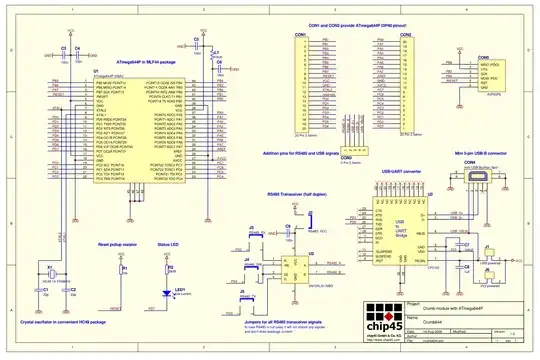

The left side of the image shows how to interface ATmeaga664. However, the principle is the same for the 328 model, I believe:
If you do not have any other power consumption except your microcontroller, you might not need a 10uF cap. But I would suggest to use both 10uF and 100nF in parallel. I had a similar question here. Notice, that analog AVCC is connected to supply through an inductor. Do not know what it is for. Look at the datasheet, I they might have some examples.
Edit: According to LM1117 the datasheet, there should be a 10uF on the input and the output. Then do so.
