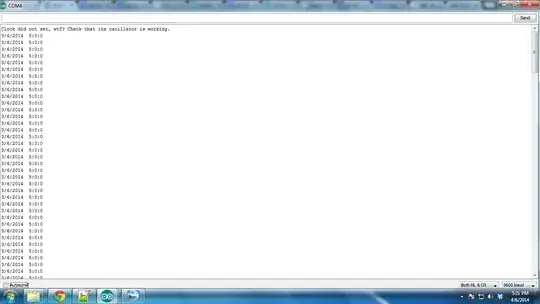

This code however gives me this output.
Code output
And with this output it is quite clear that my oscillator is not working, although I am able to set the date and time (but that time is not increasing). Here is the wiring scheme which I used

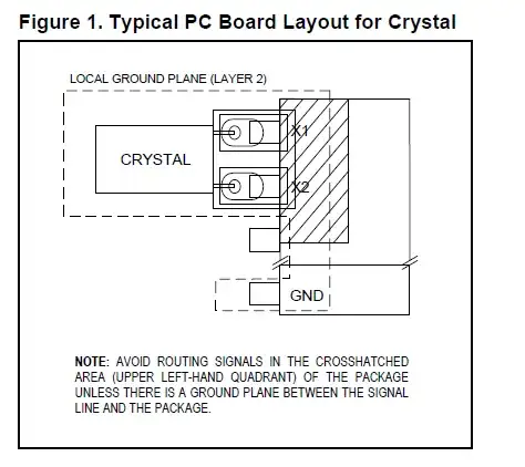

Also, you need to double-check whether you've followed the board layout restrictions regarding ground and signals going near the crystal pins, as per datasheet. I'm copying the relevant part below:
Restrictions for board layout for DS1337
If there's a signal going near the crystal pins, the internal IC registers will get corrupted. Then you'll get all sort of weird symptoms. That may be the cause of your problem.
I got sloppy in one of my layouts with the DS1307 RTC and got similar problems. In my case, I could set the time, but the minutes register would decrease unit by unit, randomly.
If you're board doesn't follow the recommendations, one way of fixing it is to ground crystal case (like so: Is case grounding compulsory in typical 32.768kHz crystal for Real Time Clock?). That did the trick for me.
Edit: Looking again at your serial monitor printout, it looks like your code was not able to set the clock time. The time it's printing on serial is likely the time you tried to set, but failed. To me, that means that the I2C communication is not working properly. Maybe it's the device address that's wrong, or a problem with the wiring. I see that you have both pull-up resistors properly wired to SCL and SDA, so that's good. But I would double-check all that wiring.

Edit 2: I still thinking you're not setting the time as you imagine. That's because the code below sets the values you defined into the C++ object called RTC (which sits in the Arduino's RAM), but it fails to set them to the RTC IC:
void setup() {
    RTC.start();
    RTC.setSeconds(00);
    RTC.setMinutes(00);
    RTC.setHours(05);
    RTC.setDays(06);
    RTC.setMonths(3);
    RTC.setYears(2014);
    RTC.writeTime();      // I think this line is failing
    // But the lines above succeed in setting the time into RAM (but not on the RTC)
Then, you print the time inside loop(), but using the values in RAM:
void printTime(byte type) {
    Serial.print(int(RTC.getMonths())); // these values come from RAM, not the RTC
    Serial.print(int(RTC.getDays()));
    Serial.print(RTC.getYears());
    Serial.print(int(RTC.getHours()));
    Serial.print(int(RTC.getMinutes()));
    Serial.print(int(RTC.getSeconds()));
To confirm that, try running the code below:
void setup() {
    RTC.start();
void loop() {
    RTC.readTime();
    printTime(0);
    delay(1000);
If time isn't set, it will print a bunch of zeroes like 0/0/0 0:0:0. If time is set, then it will print 3/6/2014 5:0:0
