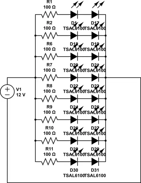

I'm trying to design a LEDs lamp with an homogeneous output for a radiometric experiment (so I don't care about energy consumption but I would like a safe prototype, so I prefer a low voltage, that works decently even if is not the best way to do it). So far I've seen different approach: in this video seems that for build an LEDs matrix I should use a resistor for every LED. However I think that parallel arrangement does not produce an homogeneous output, (i think some LED will be brighter...) so I think Spehro answer to my first question could be the best alternative, however I don't understand how to design the last part of his circuit (op-amp, BJT... ) furthermore I think that a long series could have the same effect due to the non-ohmic nature of LEDs (Am I wrong?). So I've tried a different approach but I don't know if it is right. Here is the schematics:
schematic
simulate this circuit – Schematic created using CircuitLab Assuming that LED's If=100mA and Vf=1.35 V and I have a 12 V source, if I'm not wrong I need: $$ R=\frac{12V~-(1.35V \times 2)}{0.1A}=93\Omega$$ so I can use a 100 Ohm resistor (I don't know why I can't run the simulation, but power consumption should be under 4 W).

There are two things to consider in trying to match the light output of multiple LEDs
  1. Controlling the current thru each LED.
  2. Compensating for light output variances between LEDs even when driven with the same current.
The first is not that hard to guarantee electrically. The brute force way to ensure the same current thru all LEDs is to put them in series. That will require the highest drive voltage, but the currents will be equal.
It is not clear if you also care about variations in light intensity between LEDs driven at the same current. If so, it gets trickier because these variations by their very nature are device by device and can not be known other than by explicit testing.
The first order answer is to simply string the LEDs in series with a resistor, using a high enough voltage source.
The second order answer is to do the same thing but specifically buy matched LEDs, or buy a large quantity and find matched ones yourself. LED manufacturers routinely measure the light output of individual LEDs and "bin" them according to brightness. Buying a set of LEDs binned to the same brightness is more tricky, and may require working with your distributor or directly with the LED manufacturer if the volumes are high enough.
The third order answer is to trim the light output of each LED separately. To do this you will need some means to measure the light from individual LEDs, and to adjust the current thru individual LEDs. This is obviously the most complicated approach and requires the most parts, but produces the best match.
There are various ways to trim the light output of each LED. Which one is appropriate depends a lot on parameters you haven't given us, like the number of LEDs and and how close "close" is. Also, how automated must the trimming process be? Is this something a technician can do laboriously once, or must it be easy to do by unskilled people at unforseen times?
Added:
We finally have a spec that says the light output of each LED can vary up to 5% of nominal. That is quite tight. A human wouldn't be able to see a 5% difference in intensity even when the two LEDs are viewed side by side. This is therefore tighter than I think you can get by buying binned LEDs. I may be wrong, so check with some distributors or manufacturers. However, I'll proceed here assuming you can't buy LEDs this close to each other in brightness, and therefore individual trimming is required.
You didn't say what kind of LED you will be using or a link to a datasheet, so I'll do this example for ordinary green LEDs with a maximum sustained current of 20 mA and a forward drop of 2.1 V. The same topology will work for other currents and forward drops, but of course will require different values in the circuit.
Here is a circuit per LED that should allow you to get what you want:
The "3.3V" supply is intended to be well regulated and is used as a voltage reference. The 5V supply does not need to be very accurate, and significant ripple can even be tolerated. The easy way to get both these is to go out and buy a 5 V supply, then use a linear regulator to make the 3.3 V from it.
This circuit works by using the bipolar transistor as a current sink. It is exploiting the fact that the collector current varies little as a function of collector voltage as long as that collector voltage is above some minimum, like 1 volt or so. The base voltage is adjusted by the R4-R3-R2 divider chain to keep about 1 volt accross R1, which keeps the LED current close to 20 mA.
With 1 V on R1, the collector should be at least 2 V to keep the transistor regulating the current nicely. In this example the LED drops 2.1 V, so the minimum the "5V" supply can be is 4.1 V. Higher voltages will work too, but cause increased dissipation. Any off the shelf regulated 5 V supply should work fine here. Since you want to support up to 22 LEDs and each will draw 20 mA, the supply must be able to source 440 mA for the LEDs alone. Leaving room for another 2 mA per LED for the control circuitry, the current requirement is close to 1/2 A. A 5 V 1 A supply can therefore easily do this. Fortunately those are cheap and available.
To trim this, turn down all the R3 pots to their minimum end (wiper is effectively between R3 and R2), then apply power. Use a voltmeter to adjust each R3 so that the corresponding R1 has 940 mV accross it. This step guarantees that none of the LEDs are overdriven, but all are close to their upper limit. Now go around and measure the light output of each LED to find the dimmest one. Then adjust R3 of all the remaining LEDs to match that light output.
One way to measure relative light output would be with a CdS photoresistor in a Wheatstone bridge driving a voltmeter. If you put a small pot in the bridge, you can trim it for null output from the dimmest LED, then adjust the others to get that null output. In any case, there are various ways to measure light, so getting into that more is a side issue to this question.

Assuming your resistors are similar and your LEDs are well matched, the circuit that you have show will give equal brightness.
However, because there are manufacturing differences between both the LEDs and the resistors, it won't quite be equal. You could do some voltage matching between LEDs to be the same. Basically, put an appropriate resistor in line with the LED, and measure the actual voltage drop. Put the LEDs in series so that the total voltage drop between each set of LEDs is as close as possible.
However, it's pretty simple to drive it with line voltage. If you used 40 LEDs, that would drop 108 volts, and to drop the remaining 12 volts would take a single 120 ohm resistor. That would dissipate 1.2 Watts. I'd suggest using three 39 ohm 1/2 watt resistors in series.
This gives you 100 mA through every LED.
I would recommend a full-wave rectifier as well, so that you have reduced flicker.

Which is the best way to have the same brightness from all the LEDs?
There are three options: -
  1. Accept the manufacturing differences in light intensity between LEDs in a batch you buy
  2. Use a light meter and calibrate/test each one on a precision current source and be prepared to throw away 50% that aren't "good enough"
  3. Put variable resistors in series with each one and wire in parallel. Adjust the resistor to match the light output to the rest.
End of.

Which is the best way to have the same brightness from all the LEDs without use a dangerous voltage?
Best depends on how complex you get and how matched you need. A simple method for a one off project, is taking a bunch of leds, say 4 parallel strings of 4 in series with an appropriate resistor on each. Light them up, then move them around by hand to match each string. Once you have done the best, you start adjusting the resistors until all 4 strings match. A small trimpot would be useful. You might need more than just 16 leds, if some are completely unmatchable.
I've done this with 7 individual leds for a larson scanner. Some of my red leds just dont have the same color tone.
And just for curiosity Which is the best way at all, no matter voltage or power consumption?
Again, depends on your needs. You can use a digital led control IC that has current matching as well as individual channel spot correction.

You should worry more about optical part of your light source device.
Your circuit will be pretty homogeneous.
You can use resistors with 1% tolerance if you want more precision
or
buy more 5% resitors measure all of them and only pick resistors closest to 100 ohm.

It may be possible to use a multichannel driver with dot correction such as the TLC5940 and adjust the dot correction of each channel individually until each LED appears the same. The '5940 can sink up to 17V, and 120mA when VCC is above 3.6V.
