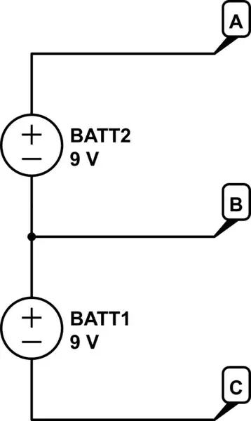

You seem to be confusing (as I did) ground with protective earth. "Ground" is the reference point for the voltage potentials in the circuit, is designated 0V, and all other voltages are compared to that. Consider this circuit, where power is provided from two 9V DC batteries in series:
schematic
Any of the points A, B, and C may be considered ground but the circuit will be considered to have different voltages depending on which point is selected. If point A is ground, B is -9V, and C is -18V; if B is ground, A is 9V, and B is -9V; if C is ground, A is 18V, and B is 9V.
Protective earth, on the other hand, is used in high-voltage AC circuits to provide a safe path for unexpected current, protecting people and property from electrocution, failure, and fire.
Unfortunately, both "ground" and "protective earth" are often referred to simply as "ground" (especially, in my experience, by people who work exclusively with one or the other but not both).
Caveat: I'm new at this too, and hoping to learn from this answer as well. If there's anything I've missed (or I'm just plain wrong), please don't hesitate to comment and/or edit! Thanks.

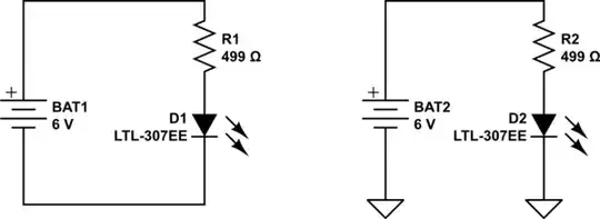

Below, in the simple DC circuit on the left, there is an explicit wire connecting the ground lead from the battery to the minus side of the LED. In the circuit on the right, ground symbols (the open triangles) are used instead; in a large circuit there will be ground symbols scattered all over a schematic, all assumed to be connected together. (Sometimes other but similar symbols are used for ground.) These two circuits are identical.
schematic

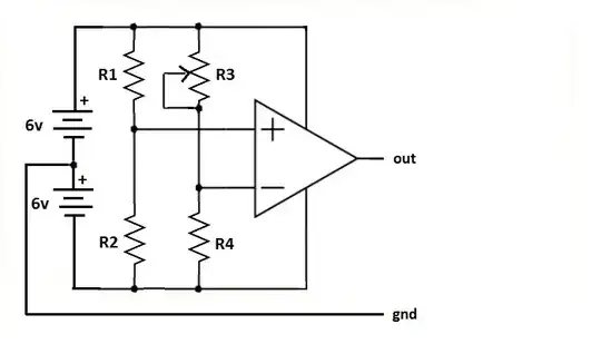

The one exception to the ground being the lowest potential in a circuit is when you have both positive and negative supplies, such as in the following circuit:
Here there are two batteries, so you have both a +6v supply and a -6v supply, relative to the ground lead between them. The reason for the two supplies is the comparator, which needs both positive and negative supply voltages. This means the output of the comparator will also swing both positive and negative. Op-amps are another type of IC that sometimes require both positive and negative supplies. However it is more common for both op-amps and comparators these days to require only a positive supply.

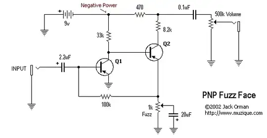

    It's not really true that "Traditionally, "ground" is the lowest potential in a circuit". In fact when PNP transistors were preferred Ground was traditionally on the +Ve battery terminal and the Supply was -Ve. See http://www.muzique.com/lab/fuzzface.htm for context. – akellyirl Mar 26 '14 at 09:53
As others have said, the Ground reference in a circuit is a Relative point; i.e. Voltages are defined in that circuit with respect to the chosen Ground reference.
Historically Germanium Transistors were mostly available as PNP devices. In these circuits a Negative supply was the norm with Ground being chosen as the +Ve potential.
The circuit below is from a classic Guitar effect unit (source)
Notice the +Ve of the battery is labelled as Ground and the power is Negative.

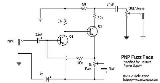

But this ground scheme may be incompatible with other Guitar Effect units....
So it can be redrawn:
