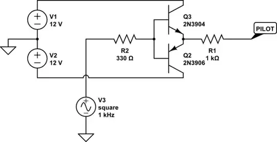

The context here is the pilot generator for a J1772 EV charging station. The specification calls for a 1 kHz +/- 12 volt square wave with varying duty cycle. The output is sent through a 1 k resistor on its way out the door.
So far, two different solutions to this problem have been presented by the OpenEVSE community at large.
Solution 1 is an LF353 op amp driven by an unregulated bipolar 12 volt supply. The problem is that the LF353 is not rail-to-rail, and so the output impedance has to be adjusted to account for the reduced voltage. That works, but it's not compliant with the specification.
Solution 2 is to use analog switches, such as the DG303A to select between regulated +12 or -12 volts on the output. That works very well indeed, but the BOM for that is about $5 just by itself.
It seems to me that there ought to be a much, much simpler way to achieve it. The analog switch seems to me to be vast overkill given that we're simply selecting between two regulated voltage levels given a logic level input.
I've tried to use circuitlab to come up with BJT or FET based switching, but gotten nowhere. It seems to me like some kind of simple push-pull "amplifier" is exactly what the doctor ordered... isn't it?
One of my (perhaps laughable) attempts:

    I'd look at adapting an existing RS-232C level converter circuit for a "hard" ±12V. – Ignacio Vazquez-Abrams Mar 19 '14 at 20:11
  • You should show us the circuits that you have tried. It doesn't help anyone if we suggest ideas that you have already discarded. – Joe Hass Mar 19 '14 at 20:53
  • @JoeHass I know a picture is worth a thousand words, but an op amp wired as a comparator and an analog switch with a simple logic input wired to +12 and -12 don't seem like they'd be particularly illustrative to me. – nsayer Mar 19 '14 at 20:56
  • You said you used circuitlab to "come up with BJT or FET based switching". Show us those circuits. – Joe Hass Mar 19 '14 at 20:57
  • Do you already have the regulated +- 12v? – tcrosley Mar 19 '14 at 21:01
    @tcrosley Yes. I have SMD 7812/7912s being fed from a +/- 15 DC-DC converter. The cost reduction I seek is "downstream" of that. – nsayer Mar 19 '14 at 21:20
Use an RS-232 transceiver IC. You don't say what the 12V tolerance is, but you might be able to get rid of your DC-DC and linear regulators if the +/- voltage from a charge-pump IC (max232) is good enough.
Otherwise, just connect the supply directly to a non-charge-pump transciever. Use MC1488/SN55188/SN75188, which has a 300 ohm output impedance, so your added series resistance would be 700 ohms.

  • Looking at the MC1488 data sheet, there's a pretty big drop from the power supply voltage to the output voltage, and it appears to have a fairly loose tolerance in that regard. The LF353 solution looks to be beating it, at least from what I see. – nsayer Mar 20 '14 at 00:03
  • That's the 300 ohm output impedance. The open circuit voltage is less than that. You can use the CMOS version (MC14C88/DS14C88/75C188) and wire all four drivers in parallel to get closer to the rails. But it will be better than a LF353 regardless. – markrages Mar 20 '14 at 00:54
I believe I figured out the way I was looking for. It's certainly cheaper than the switch IC. I basically started with the idea of designing a "high side" switch circuit and then basically tried to come up with the compliment. The real "aha" moment was in realizing that the "primary" side of the compliment was going to need to be an emitter follower from the logic "high" level.

  • Since this answer was posted, I changed the design to use MOSFETs for speed. On the "left" pair the gate (formerly base) bias resistors are 0Ω, and there's a 10kΩ pull-up to +5 to protect against floating input (during controller reset). On the "right" pair, each gate has a 1kΩ resistor to source and a 10kΩ resistor resistor to the previous stage's drain. This makes each secondary MOSFET turn off quicker than turn on, which reduces transient current. The result is < 1µs rise/fall time to 90%. – nsayer Jun 28 '16 at 16:32
