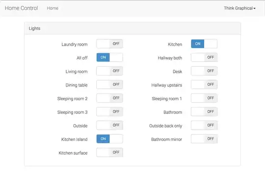

Then I've build a little interface to easily turn on/off the lights:
Arduimotic Home Control
