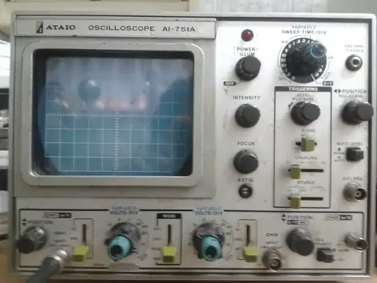

I got an old CRT oscilloscope someone had laying around unused in his garage (an ATAIO AI 751A which seems pretty obscure, not getting any meaningful Google results). Unfortunately the user manual is missing, I couldn't find it online and this is the first CRT oscilloscope I work with, so I'm not sure if I'm operating it properly.
It powers up but there's nothing on the display when the probe is not touching anything, even when it is set to GND. Touching the probe's tip triggers a (very flickery) 50Hz ~10mV peak to peak signal (yes, I'm european) but setting it to GND to center the signal vertically stops showing the signal. At dual display mode both channels are shown when I touch the tip in channel 1 (channel 2 disconnected is shown at ground level), but as soon as I release the finger, both channels are gone too.
Touching a 9V battery gets a single sweep when the tip touches or releases the battery, while I'd expect at least that channel to be shown at a constant value.
Setting a high period for the time division and touching the tip triggers a single sweep, but as soon as it reaches the far right it stops. I can trigger another sweep touching or releasing the tip again.
I pressed a switch labelled "Auto Level" which I think should make the trigger level automatic based on the last samples (which seems plausible since the trigger controls don't do anything when auto is on) but still nothing is shown on the display when touching a 9V battery.
Fiddling with the controls (e.g. pressing the "Auto Level" switch) triggers a single sweep too.
Is the oscilloscope broken or am I doing something wrong? Where should I start troubleshooting?

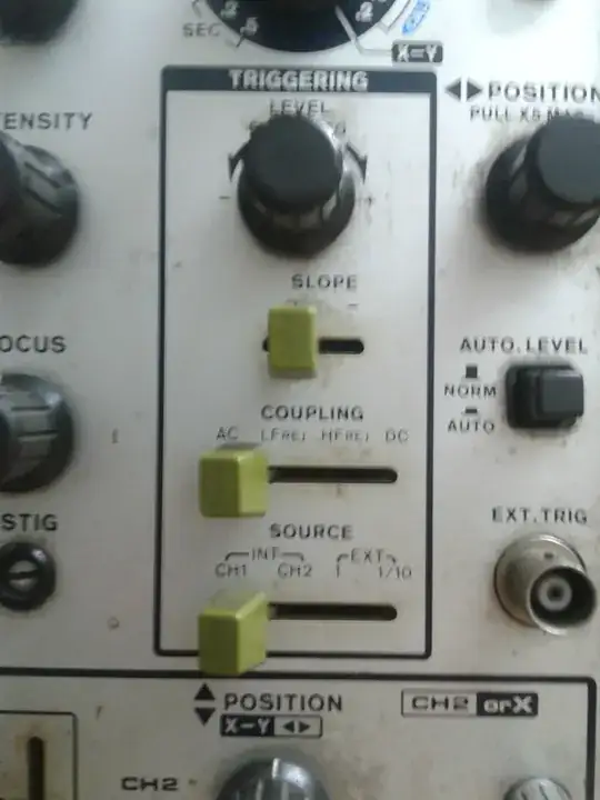

Images: (don't pay attention to the settings)
Full oscilloscope enter image description here
Triggering controls close-up enter image description here

Pull out the trigger level knob. This will put it into "auto" trigger mode, which basically means it will automatically start a new sweep a short interval after the previous one ends. This will give you a continuous trace even with a DC input signal.
On modern scopes that have microprocessors, "auto" now means something completely different, in which the micro searches for a set of vertical and horizontal settings that give a "reasonable" display (YMMV).
The "Auto Level" button does something different: It uses a pair of peak detectors to determine the swing of the signal, and places the trigger level at some intermediate (50%?) value.

  • No fair figuring out the answer with a photo to work from ! ;) – Scott Seidman Mar 17 '14 at 21:46

  • Yes, there is a square wave output for calibration! Completely missed that, very convenient. My trigger settings are set to: "Slope +", "Source CH1", "Coupling DC" and a "LEVEL - PULL AUTO" knob which does what it should with AC as far as I can understand, but nothing when touching the battery. It still seems weird I can't get the flat output even with input set as GND. – DuckTyped Mar 17 '14 at 17:45

  • Thanks for the photo. I mean the blue knobs inside of the gray knobs. You should DC couple your trigger. – Scott Seidman Mar 17 '14 at 21:44
