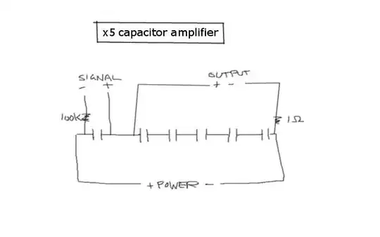

Here's a schematic of an amp purely only using capacitors:
From https://www.eevblog.com/forum/beginners/tested-capacitor-amplifier/

    Welcome to EE.SE. Link-only answers are frowned upon as they are useless when the link dies. You should at least explain the principle of operation and, ideally, include a schematic with credit to the authro. – Transistor Sep 08 '21 at 14:13
