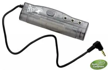

A parallel load, like resistors, would work, but like any parallel load, will draw more current or share the existing one, resulting in a lower signal at the input. Anyone that has used a headphone splitter will notice this. The solution to that would be an amplifier, like used in powered headphone splitters. enter image description here
But your issue doesn't require a parallel load. The powered splitter is just a couple of opamps as buffers and amplifiers, and is the same thing you need.
An opamp in buffer mode, will provide a constant load for the iPhone that should prevent the impedance check from pausing the music, and will prevent any lowering of volume that a parallel load would. Since it is being used to buffer and not amplify, there should be no clipping and very little to no audiable change in sound quality.
