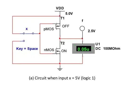

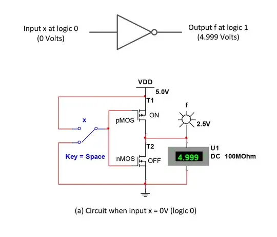

I'm completely stumped on where to start with this, any point in the right direction would help. The work gave me a circuit drawn out and asks 2 questions:
1)Determine the number of transistors required to build the Canonical expression 2)Determine the number of transistors required to build the minimal SOP expression
I don't know where to start and have read what I could, I just need some help starting and understanding how to work this out. I can show the circuit if necessary. There's a circuit showing input x at logic 0 (0 Volts) and output f at logic 1 (4.999 Volts) and all the other details like nMOS, pMOS, VDD, off, on, etc. What do I usually need to learn to understand how to find the number of transistors? Sorry for a dumb question because I know how simple this possibly could be.

Here's one of the pictures:

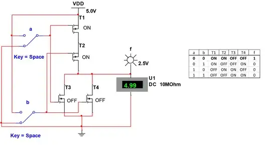

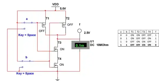

  • The last two circuits (with four transistors each and truth tables) are NAND and NOR gates respectively. – tcrosley Feb 24 '14 at 05:25

Then the logic gate in your picture is basically an inverter (a.k.a. "not" gate, see here http://en.wikipedia.org/wiki/Logic_gate). As the name more or less indicates you get at the ouptut the logic level "inverse" (exact term?) of your input (e.g. apparently TTL, +5V out for 0V in, in your case).

  • @user2318083 Well you gave only "one of the pictures", so it's difficult to get a good idea... Are there more logic gates or schematics ? You need to write the output as a result of the inputs. You do realize the similarity between the logic gate and the circuit with the MOSFETs, don't you ? Are you familiar with the Karnaugh map ? – FredP Feb 23 '14 at 21:39
  • @FredP There are more but from what I understand those are separate, I could be wrong though since I'm already puzzled at the moment. I don't know about MOSFETs and I'm very familiar with Karnaugh maps. It's just the very first time I've seen this and never even had any idea of it before this. The professor kinda threw this at us. I can go ahead and upload the rest if that'll help. It'll be in the original post within a few minutes of this post. – user2318083 Feb 23 '14 at 22:07
  • @user2318083 Take a look here http://en.wikipedia.org/wiki/MOSFET you might recognize something from your schematic, and I insist on the similarity with the logic gate. If the rest is really separate (are you sure ?) I don't think you need to post all, maybe just another example. – FredP Feb 23 '14 at 22:13
  • @user2318083 ok you even have the logic tables... you need to find the formula so that the output ("f" in the table) is HIGH in function of the inputs, like in the last one, f is HIGH in only one case : a and (hint, hint) B are both LOW. – FredP Feb 23 '14 at 23:02
