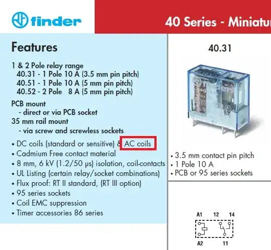

There are quite a few relays (also contactors/breakers) which are powered from AC. Putting a diode inside renders them useless for AC applications: -
