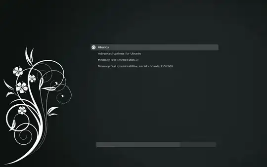

Trying to use new boot-loaders but failing in which I finally gave up. After a lot of struggle, I succeeded in modifying GRUB2 to a new theme (downloaded from here) by using GRUB Customizer.
Here is what I did:
  1. Downloaded the theme.
  2. Installed the theme using grub-customizer [Grub Customizer > Appearance Settings > Theme > Add].
  3. Saved the setting and updated the grub using this command:
    ~$ sudo update-grub2
  4. Restarted the system and the theme got applied.
Now my boot menu looks similar to this one:
(source: pling.com)

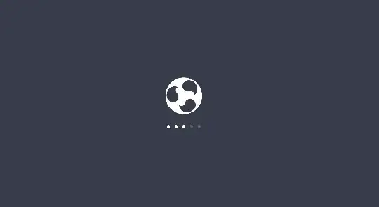

I also themed plymouth boot screen following these steps:
  1. Installed plymouth themes using the following command:
    ~$ sudo apt-get install plymouth-theme-*
  2. Changed the theme using this command:
    ~$ sudo update-alternatives --config default.plymouth
  3. Then updated boot configuration using this command:
    ~$ sudo update-initramfs -u
Now my boot screen looks similar to the following one:
Sadly neither BURG nor rEFInd worked for me. But I'm happy 'cause atleast I was able to replace my old boot menu with these quite cool ones. Anyways, thanks to all those who tried to help me, I appreciate their efforts.
