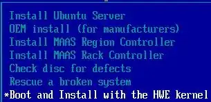

I installed the Ubuntu-16.04.3-server-arm64 (hwe) on my ARM64 server.
