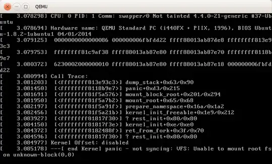

The kernel panics saying:
kernel panic-not syncing: VFS: unable to mount root fs on unknown block(0,0)
I need to boot this kernel+initrd pair over PXE. What am I doing wrong?
