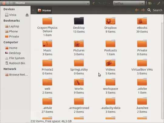

This is the result for size 48 : size 48
