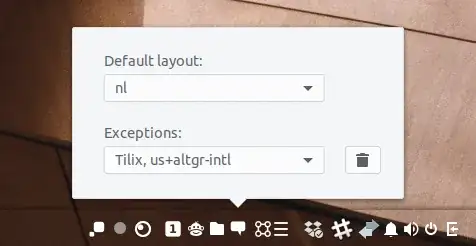

Not directly what you asked for, but since you are using 17.10 and using multiple layouts, it might be useful to install the Keyboard Auto Switch, which automatically changes the layout, depending on the application:
In UB 17.10, activate backports in Budgie Welcome, update and install the applet. In 18.04, it will be available by default in Budgie Welcome.
