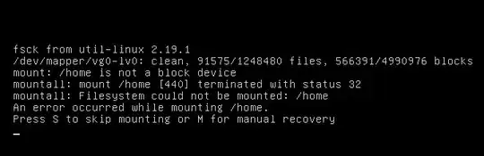

After Rebooting:
error "Filesystem could not be mounted: /home"

You need to add ,usrquota to the options of the partition that your created for this. A possible(!) valid method would be:
home /home ext4 defaults,usrquota 0 0
but since you do not have a partition with mount point home I am just guessing. After that you need to remount /home.
mount -o remount /home
and the filesystem then knows it needs to check for quota (ie. /home/aquota.user).
