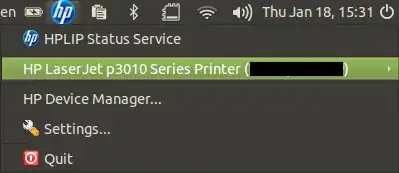

I start from Printer OFF, connected via USB to laptop, laptop OFF. I turn the laptop ON, wait for Ubuntu 14.04 to boot; "HPLIP Status Service" in the system tray is automatically shown.
hp01
I set up a terminal with tail -f /var/log/syslog; and then turn the printer ON - the syslog messages are:

Clicking on "HP Device Manager..." at this point shows (click for full size image):
