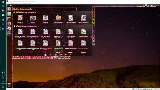

I've followed all the necessary steps to enable 3D acceleration as in here, and everything seems to have worked correctly, if it wasn't for a constant pixel flickering affecting transparencies. The flickering also affects the upper bar randomly. Here is a screenshot:
Ubuntu graphic glitch
The system seems to run a bit faster, and it's SORT of usable, but the glitch is very annoying. The solution given for this other problem didn't help.

I had the same issue as you after enabling 3D acceleration but the solution (at least for me) is in this article, at the very end.
sudo apt-get install compizconfig-settings-manager && ccsm
Go to OpenGL and untick Framebuffer Object. Also, you might want to disable effects, such as fading windows, animations and window decoration.
