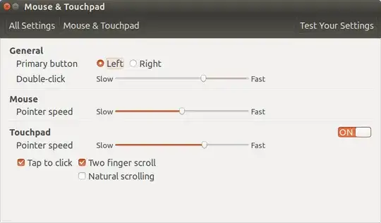

I use the regular Ubuntu 16.04 settings menu for mouse sensitivity:
Configuration files are all defaults:
