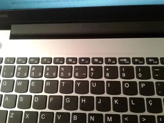

I have a notebook Lenovo Ideapad 310-15ISK and sometimes the wireless works, sometimes it doesn't.
When I turn on the notebook and the wireless works, it keep working still I turn of or reboot the notebook. When I turn on the notebook and the wireless is not working, I have to reboot or turn it on again still it works.
Note: my NB doesn`t have a physical wireless/wifi switch or a shrtcut on the keyboard. The F7 button is the airplane mode.
What I can do to fix it?
