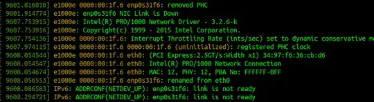

Dmesg mentions the following about the card:

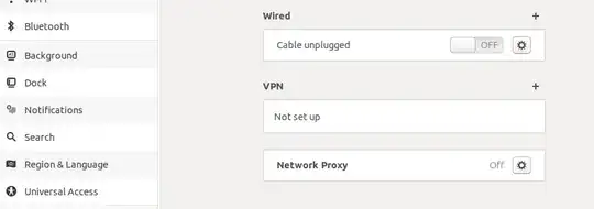

And the Gnome Network GUI shows this:

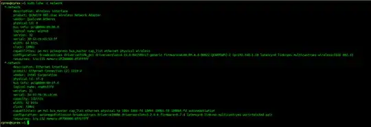

LSHW shows the following:

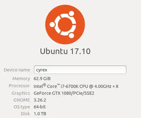

My computer is the following:
The motherboard is the Asus ROG-Maximus VIII Hero Alpha with the latest 3703 firmware update.

The ubuntuforums link that you followed is a technique to patch the driver to ignore an NVM Checksum error. This error prevents the driver from loading at all. The first symptom is that the device appears as unclaimed in lshw. As well, the error is quite apparent in dmesg; it usually manifests like:
[1.049935] e1000e 0000:00:1f.6: The NVM Checksum Is Not Valid
[1.084914] e1000e: probe of 0000:00:1f.6 failed with error -5
Since the driver won’t load, no interface such as your enp0s31f6 is created.
Incidentally, for the benefit of the searchers, there are much easier ways than hacking the driver to solve the NVM Checksum error. Please see: https://ubuntuforums.org/showthread.php?t=2351572 Essentially, it involves downloading a bit of code from Intel and running it to tell the hardware that the checksum it has is correct. Afterwards, the driver sees no checksum error, loads and runs.
It is not productive, in my opinion, to apply the checksum fix in a setting where no checksum error is evident.
In your case, I suggest that you run:
sudo ethtool enp0s31f6
I suspect you will find, in part:
Speed: Unknown!
Duplex: Unknown!
You could try telling the interface what speed and duplex to assume to see if it is helpful:
sudo ethtool -s enp0s31f6 speed 1000 duplex full autoneg on
Does the interface spring to life? If so, we can make the parameters persistent.
If none of this helps, as I strongly suspect, then I believe that the ethernet jack on the motherboard or one or more of the PCB traces to the actual chip is defective.
Intel gigabit ethernet cards are inexpensive and readily available. I suggest that you abandon the defective on-board chip.
