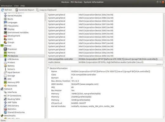

How to check the video memory size of my Graphic card? I used (System Profiler and Benchmark) and it showing me that I have only 256MB but I have the Nvidia GTX 1050 Ti 4GB.
Meky
  • 45
First install the nvidia additional driver and then you will see all details informations about your video cards with the nvidia tools: nvidia tool
Usually it is installed with driver, you can launch it from menu, it is named NVIDIA X Server Settings.
