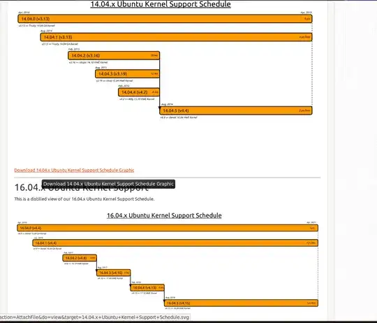

Charles Green
  • 21,859
It appears that your system has not been updated to the HWE stack. You can see from this graphic that 3.13 is the GA kernel, and in August 2016 users were advised to update to the HWE stack.
Here are the procedures for 14.04 from the official wiki page.
Ubuntu 14.04 LTS - Trusty Tahr
The 14.04.2 and newer point releases will ship with an updated kernel and X stack by default. If you have installed with older media you can use the following to install the newer HWE kernel derived from 16.04 (Xenial):
Desktop
 sudo apt-get install --install-recommends linux-generic-lts-xenial xserver-xorg-core-lts-xenial xserver-xorg-lts-xenial xserver-xorg-video-all-lts-xenial xserver-xorg-input-all-lts-xenial libwayland-egl1-mesa-lts-xenial
Multiarch Desktop
If you run a multiarch desktop (for example, i386 and amd64 on amd64, for gaming or Wine), you may find you need a slightly more involved command, like this:
 sudo apt-get install --install-recommends linux-generic-lts-xenial xserver-xorg-core-lts-xenial xserver-xorg-lts-xenial xserver-xorg-video-all-lts-xenial xserver-xorg-input-all-lts-xenial libwayland-egl1-mesa-lts-xenial libgl1-mesa-glx-lts-xenial libgl1-mesa-glx-lts-xenial:i386 libglapi-mesa-lts-xenial:i386
Server
Install the HWE kernel derived from 16.04 (xenial):
When I did this, I had a question regarding the Multiarch Desktop part - how do I know if this applies to me? Reference: How to tell if my system is "multiarch"?
The answer is to use the command
dpkg --print-foreign-architectures
and if you get an output, your system is multiarch.
