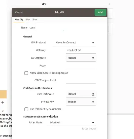

However, I would like to use Ubuntu's GUI to do this. I have this successfully installed. When I go to create a VPN connection I get Cisco AnyConnect Compatible VPN (openconnect) option. When I create one, I am able to use VPN protocol Cisco AnyConnect put in my gateway, vpn.host.biz. However I am unsure what to do from here. I have no option in the settings to add a username, just a CA Certificate, User Certificate ... options that ask me to point to a file. I do not have anything like this. If I leave all the rest blank and try to turn the VPN on, it doesn't connect. As soon I click it on, it turns off.
screenshot
Is there something simple I am missing with this GUI? Is it something that the GUI won't trigger the two factor authentication so the connection is immediately refused? Thanks!

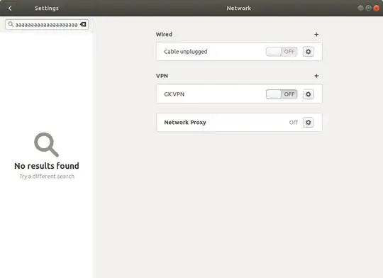

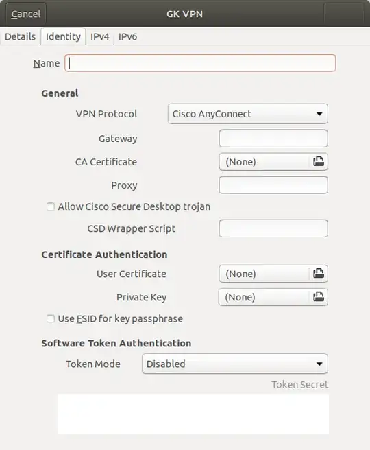

I opened the network settings and clicked the plus sign VPN section.
I entered the identity of my VPN e.g. XYZ VPN, and entered vpn url to the gateway e.g. vpn.xyzvpn.com
Add button appeared on top right. Added that Vpn. Then,
Then just turn your vpn ON and if the gateway you entered gets connected you'll be prompted for a Group, username and password. Enter your details there, and login info can be saved too for next use.
