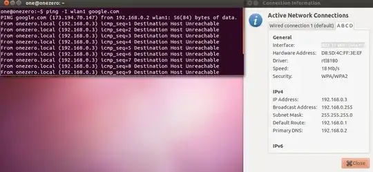

Lan ip 192.168.0.2 > Working Properly enter image description here
Wlan1 ip 192.168.0.3
pin -I wlan1 google.com
UPDATE
Try pasting the output of route -n and/or ip route. Seems to me that the wlan1 interface hasn't a valid gateway configured. –@MrShunz

Now, for all this to work, you have to configure some "advanced" routing. As you can see from the output of route -n you have multiple networks, but only ONE gateway to the Internet. That is good, as multiple gateway routing is quite an advanced topic and somewhat difficult to handle well.
This goes beyond what you asked in the original question. I suggest you to post a new question here or on Server Fault asking how to configure and manage multiple internet gateways on multiple network interfaces.
Or, better yet, try googling it ;) Also check the LARTC site for advanced linux routing configurations.
