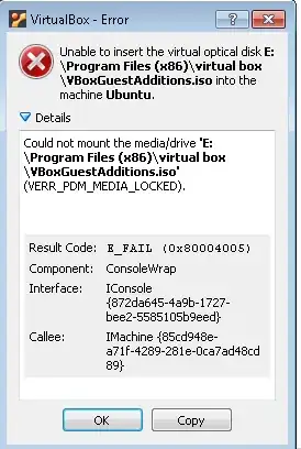

When trying to insert guest additions CD image, I get this error:
could not mount error

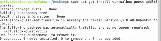

sudo apt-get install virtualbox-guest-additions-iso and this gives:
already the newest version
