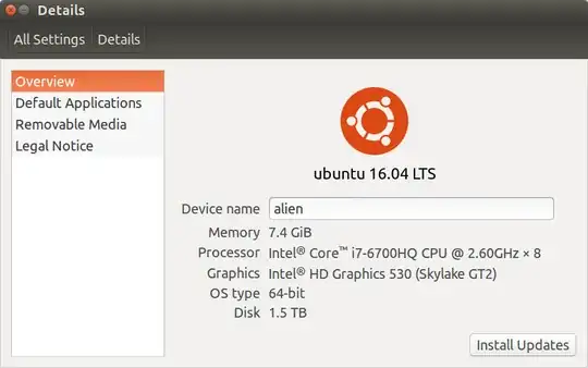

I have Ubuntu 16.04 and when I go to into my settings into the Details/Overview page I see a button on the bottom right that says: "Install Updates". Pressing it gives a small progress windows, that does not really install anything new. How can I change the button to display system up to date, instead of doing this pseudo update nothing thing?

When you select System Settings, Details your screen looks like this:
Settings Details Install
The lower right option "Install Updates" could best be described as:
  • Check if updates exist and then give me option to install them

Summary
The option on the Details screen is designed to check if updates exist when you click the button. To have it check for updates before mounting the screen and changing the button to "System up to date" or "Install Updates", would provide a delay of many seconds to a minute. A third button label of "Internet unavailable" would also have to be created.
I don't think the change you are seeking is possible for the System Details screen.
