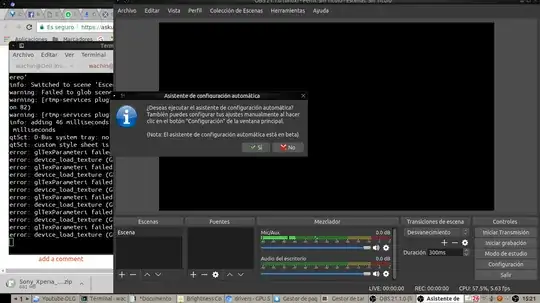

For Xubuntu 18.04 working but with:
LIBGL_ALWAYS_SOFTWARE=1 obs
see this snapshot
obs in Xubuntu 18.04
Note: I am using fluxbox Window Manager
