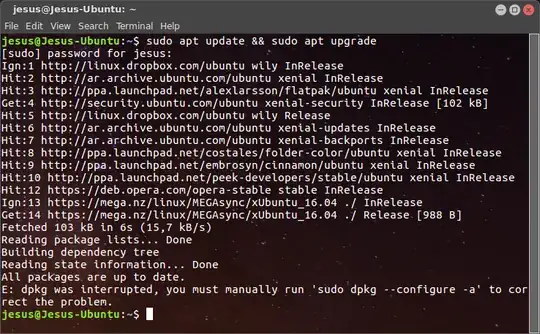

The software manager seems to be unable to install deb files; For example, I have tried to install MegaSync from its .deb file, but when I click install, it looks like if it began loading and then the install button appears again as if it wasn't touched. Here's a GIF of what I'm talking about:
GIF
Doesn't even ask for my password, and of course, the software doesn't install. It's strange, because I could install Opera using a .deb file before.

  1. The error message in your comment says that dpkg was interrupted. First you must run the command sudo dpkg --configure -a in the terminal to correct this problem.
  2. You mistakenly downloaded megasync-xUbuntu_16.10_amd64.deb, however you are using Ubuntu 16.04, not 16.10, so download megasync-xUbuntu_16.04_amd64.deb for Ubuntu 16.04 instead.
  3. Then try to install the MegaSync .deb file again by changing to the directory that contains the Megasync .deb file that you downloaded (megasync-xUbuntu_16.04_amd64.deb) with cd and running this command:
    sudo apt install ./megasync-xUbuntu_16.04_amd64.deb
    The advantage of this command over sudo dpkg -i megasync-xUbuntu_16.04_amd64.deb is that it automatically installs the package's dependencies along with the package.
