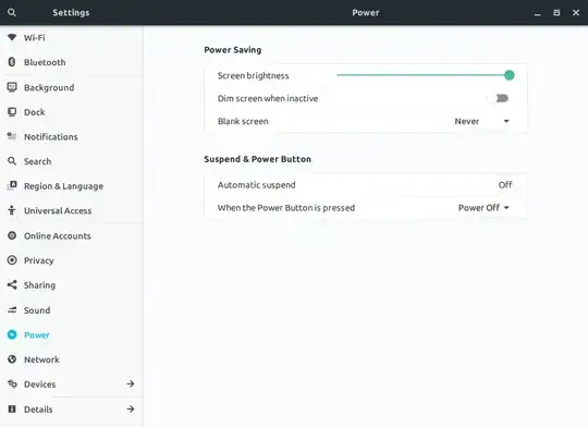

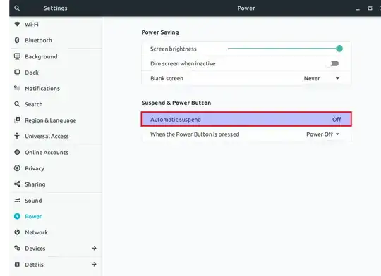

It's so because Automatic Suspend may be off.
Turning it on will solve the problem. Here is how:
  1. Go to Settings > Power.
  1. Click 'Automatic Suspend' option.
  1. Turn "When Idle" option on.
Done. Let me know if this solves your problem or not.
