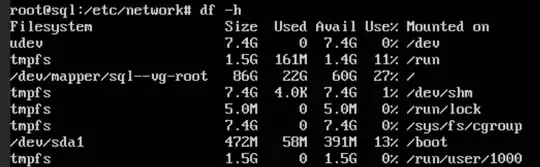

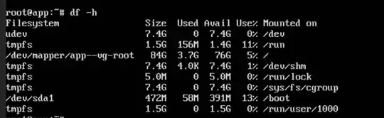

df -h output on both servers as requested:
Screenshot 1 Screenshot 2

The root cause could be an attempt to allocate more space for a file than the system has available or perhaps a corrupted filesystem (whether actual or virtual disk). I would expect the full error in the first case to be fallocate failed: No space left on device
