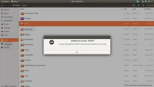

My system got updated from Ubuntu 16.10 to Ubuntu 17.04. At the time all things were working well. But after that in a few days update to Ubuntu 17.10 was also available so I updated it.
After the update to Ubuntu 17.10, my mounted network folders are not working now. When I click on a mounted folder it gives me permission issue message as displayed in this image:

//177.10.10.123/DEV6 /home/nilesh/DEV6 cifs uid=nilesh,rw,username=usernamehere,password=pwdhere,iocharset=utf8,sec=ntlm  0  0
I have tried by adding vers=1.0 in fstab lines mounting shares but it's still not working.
What is the solution?
I have also tried to execute 'sudo nautilus' command but getting below error
Invalid MIT-MAGIC-COOKIE-1 keyUnable to init server: Could not connect: Connection refused
(nautilus:9087): Gtk-WARNING **: cannot open display: :0
There's a few mount options you don't have and need.
Firstly, you need the user option to allow non-superuser to use the /etc/fstab defined mount point/rules. This is an option listed in man fstab 5:
   The fourth field (fs_mntops).
          This  field  describes  the  mount  options  associated with the
          filesystem.
          It is formatted as a comma-separated list of options.   It  con‐
          tains at least the type of mount (ro or rw), plus any additional
          options appropriate to the filesystem  type  (including  perfor‐
          mance-tuning options).  For details, see mount(8) or swapon(8).
          Basic filesystem-independent options are:
          user   allow a user to mount
Secondly, since this is a CIFS mount, you need to know what CIFS protocol version you're using on the share server. If you're using any Windows share pre-Windows 2006, or an old Samba share that speaks an old and obsolete protocol, you need to also have vers=1.0 in the mount options to tell it to use a CIFS share. However, if that gives you "Invalid Argument" errors, then you should try using vers=2.0. If that doesn't work, then use vers=3.0 and drop sec=ntlm (which solved my issues with Windows 2016 share mounts).
Thomas Ward
  • 78,878
The cifs option for version 1 is vers=1.0, not ver=1.0.
muclux
  • 5,324
