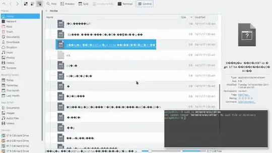

As you can see below the files have uncommon characters.
file manager screenshot
Deleting them either in the terminal or Dolphin returns the error:
No such file or directory
Running ls -la on the directory gave me this output:
-rw-rw-r--  1 aalap aalap      0 Nov 14 01:05 ??
-rw-rw-r--  1 aalap aalap      0 Nov 14 01:05 ?2?.???љ?!?Gb??σ?[?F?
-rw-rw-r--  1 aalap aalap      0 Nov 14 01:05 ??3]d???:????????1????G?p?ȋ??????嫳?d????ą-??
-rw-rw-r--  1 aalap aalap      0 Nov 14 01:05 3l??#g?w????O?JKB7?co??քH??bT?NA???S???X?I?A?qC??M?I???
-rw-rw-r--  1 aalap aalap      0 Nov 14 01:05 ??8??-?@,?Zp?[?bI????7^?ñ[?ڏ??z?O???ч??eEȰ?+??,OF??h
I ran an fsck command on the partition from another OS but it didn't change anything.
How do I remove these files?
