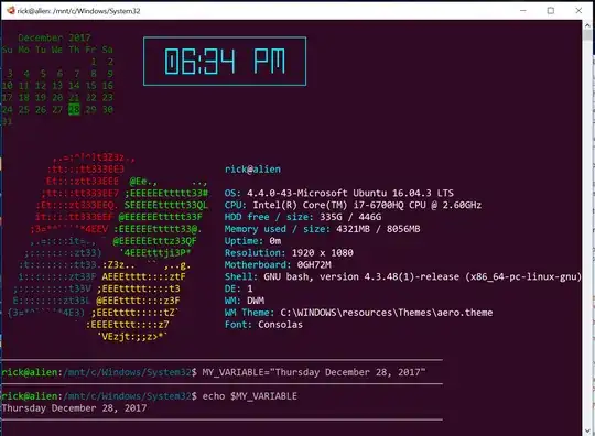

WSL Bash works the same as Ubuntu Bash
EDIT: Original answer below for historical comments. Panther's answer is best. Your ~/.bashrc file which is processed each time the terminal is opened. In it place the command:
MY_VARIABLE="some text"
Then you can use echo $MY_VARIABLE to see it's setting.
I opened a new Bash Terminal Window in WSL which works the same way in Ubuntu 16.04 except the splash screen is subtlety different:
As you can see once you set an environment variable it can be recalled normally.
