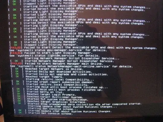

Please help me, its my workstation. It worked fine until a power blackout. Since then it doesn't boot anymore. (two times it started to the login screen, but with ENTER or a mouse click he login screen dissappeared and the screen remained black.
After that Ubuntu (eOS) doesn't boot further
Update: looked in the last_gfx_boot -> its empty syslog is here -> link to my syslog
Which steps should/could I try next?
Thanks, Florian
