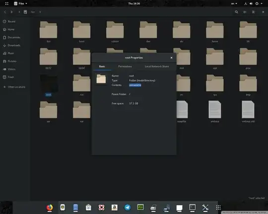

Today I want to open the root file that I got into this problem
Does anyone know what to do?
Screen Shot : Root File

Root is the user root's home folder. Normal users should not have permissions on this directory - and there is nothing inside this folder of interest.
Ubuntu does not use the root user, but the directory is required to comply with file systems standards.
Furthermore, Linux uses filesystem access control. A normal user does not have access to everything.
You may have a look at this Q&A for information on how to become the super user of the system if you need it. In general, be careful with files that require root access for editing or viewing. Changing them may break your system.
