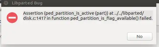

This is the message from Gparted (When I try do do any format operation) enter image description here
And this is the message alert, still form Gparted
Unable to read the contents of this file system! Because of this some operations may be unavailable.
