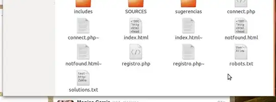

I dont know how to explain it very well so I took a picture of it.
It seems that every time I edit a Text file and save it, the sistem makes a file with the changes or whatever next to the other file. I am making a website and when I copy them through ftp it takes longer becaouse of those files, and i have to delete them one by one in the folder every time I edit them
Do you use gedit?
If so, uncheck the following settings in Edit | Preferences menu:
File Saving:
  • Create a backup copy of files before saving
  • Autosave files in every [ ] minutes
Doing so will disable these „safety features” of the editor. It might be better though to keep these enabled and run a pre-upload script to clean up the unwanted files (or filter them in your synchronization client).
