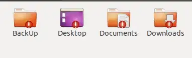

I recently installed rabbitvcs on an Ubuntu 17.10 machine.
After installing I am trying to clone one of my folders, but all my folders have an ! exclamation mark or ? question mark or a bomb sign after installing rabbitvcs. I have tried tortoise git in Windows but it didn't happen like this there.
I tried reinstalling rabbitvcs but the problem remains the same. And also the all the folders have those signs outside the folder which I am trying to clone.
Is rabbitvcs is the best alternative for tortoise git in Ubuntu for the latest Ubuntu version?
directories with ! Symbol
What is the fix for this problem? Is there any good documentation for rabbitvcs?

Try this solution found here:
  1. Kill the checkerservice.py Process under rabbitvcs
  2. Run ps aux | grep rabbitvcs
  3. Use command kill -9 <process_id_of_checkerservice.py>
  4. Restart the Nautilus and the solution worked.
