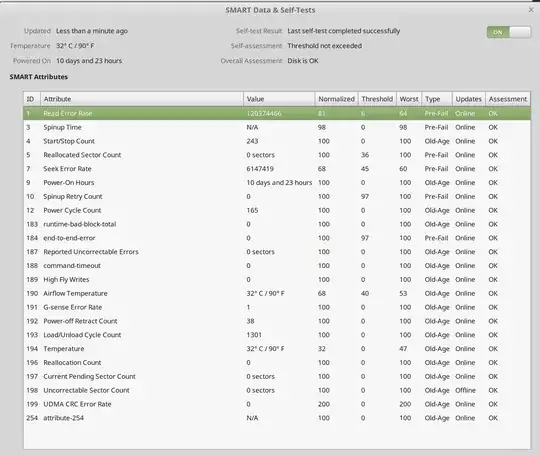

I also formatted these partitions but it still fails. If I use a fresh ubuntu install it works for a few days without any issue.
Smart extended test: enter image description here

Boot from live media and see if you have the same issue. If not, it points to a software problem, If so you have a hardware problem read on.
Identify your model and check the connection between the system board and the hard drive. If it's a cable replace it, if not ensure that the socket isn't loose on the mainboard and the drive is properly seated. If possible test the drive in another system with known good connections to determine whether the issue follows the drive, if so replace it. If anything about this answer is unclear, drop me a comment and I'll do my best to clarify.
