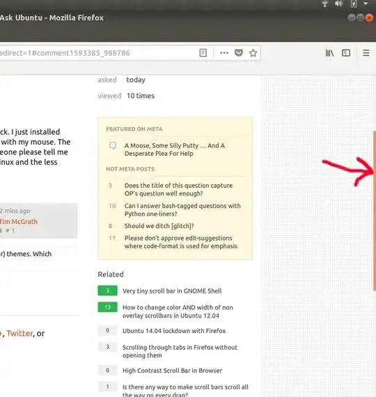

I just installed Ubuntu 17.10 and my scroll bars are WAY to narrow. I can barely grab them with my mouse. The scroll bar in LibreOffice and Firefox is so small I can barely grab it.
I have searched Google for hours trying to find a solution to this, with no luck.
Can someone please tell me how to change the width so that they're actually usable? I'm fairly new to Linux and the less complicated method, the better.
click here for screenshot

As I previously recommended in the answer to similar question you may try to remove overlay scrollbars and change CSS properties:
#Step 1
echo "export GTK_OVERLAY_SCROLLING=0" >> ~/.profile
#Step 2
mkdir -p ~/.config/gtk-3.0
cat <<EOF > ~/.config/gtk-3.0/gtk.css
/* Adding the buttons on the edges (if you don't need them, skip the next 4 lines)
.scrollbar {
  -GtkScrollbar-has-backward-stepper: 1;
  -GtkScrollbar-has-forward-stepper: 1;
/* Scrollbar trough squeezes when cursor hovers over it. Disabling that
.scrollbar.vertical:hover:dir(ltr),
.scrollbar.vertical.dragging:dir(ltr) {
    margin-left: 0px;
.scrollbar.vertical:hover:dir(rtl),
.scrollbar.vertical.dragging:dir(rtl) {
    margin-right: 0px;
.scrollbar.horizontal:hover,
.scrollbar.horizontal.dragging,
.scrollbar.horizontal.slider:hover,
.scrollbar.horizontal.slider.dragging {
    margin-top: 0px;
/* Slider widens to fill the scrollbar when cursor hovers over it. Making it permanent
.scrollbar.slider.vertical:dir(ltr):not(:hover):not(.dragging) {
    margin-left: 0px;
.scrollbar.slider.vertical:dir(rtl):not(:hover):not(.dragging) {
    margin-right: 0px;
.scrollbar.slider.horizontal:not(:hover):not(.dragging) {
    margin-top: 0px;
EOF
#Step 3
cat <<EOF > ~/.config/gtk-3.0/settings.ini
[Settings]
gtk-color-scheme="tooltip_bg_color:#ffffaf\ntooltip_fg_color:#000000"
gtk-application-prefer-dark-theme=0
gtk-primary-button-warps-slider = false
EOF
#Step 4
sudo apt-get purge overlay-scrollbar overlay-scrollbar-gtk2
It works at least on 16.04 LTS with MATE DE.
