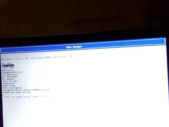

I have problems with Bios after upgraded to 17.10 on DELL Inspiron 5551 1- NO UEFI boot and can't boot from usb Ubuntu 14.04, 16.04, 17.04, 17.10, or Microsoft 8.1 all failed, also no hiren's boot can run from cd or usb only can run Ubuntu from CD on legacy choose
2- i tried to change settings to others or reset to default but always back to it's options after saving and restart, also it can save user password but no any others
3- i got HDD1 - Ubuntu drive or option instead the BIOS options, even after i removed my hard driver and CMOS battery , no saving changes and HDD-1 - Ubuntu option still there strange option instead BIOS otion

I had more or less the same problems. I am on Ubuntu 17.10 as my only OS, on an HP-envy. I could not boot from a usb drive, and I could not make changes in bios, because they won't be saved.
This link explains everything and comes up with a way to fix it, and it worked for me. It is about the new kernel of Ubuntu 17.10
https://bugs.launchpad.net/ubuntu/+source/linux/+bug/1734147
