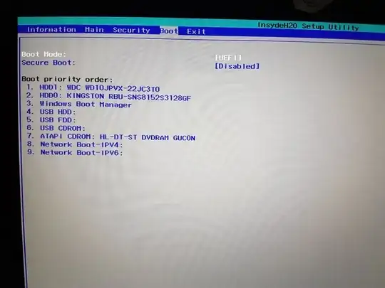

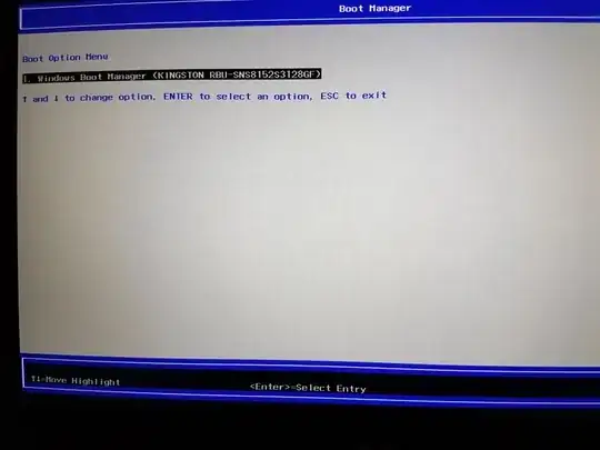

Here some pictures of the actual Boot-priority-Order and the Boot Option Menu: Boot_Priority_Order Boot_Priority_Order
Boot_Manager Boot_Manager

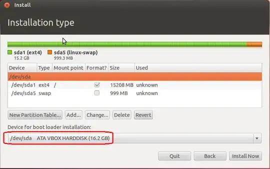

First of all, which device for boot loader installation, you selected at the time of installing Ubuntu 17.10 on second hard disk ? (as shows in below image)
It is important to select second hard disk device node for boot loader installation of Ubuntu 17.10, not first hard disk device node. In most cases, sda for first hard disk and sdb for second hard disk. So, you have to select sdb for boot loader installation for Ubuntu 17.10 for installing MBR details of on second hard disk.
After this, open the BIOS setting and change the boot disk priority. Give first/highest priority to second hard disk(which contains Ubuntu 17.10) and then first hard disk(which contains Windows).
Hope this will help.

The Trick is, that Acer won't boot Ubuntu, if Secure-Boot is disabled. So -> turning it on and selecting the right EFI-File(s) for booting, solve this Problem.
