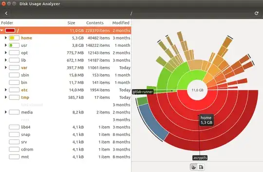

So I logged into the GUI-less shell and the first thing that shocked me was that when I hit tab, the bash auto-completion failed, because there was not enough space to create a temporary file. I was shocked, since I expected that about 90% of disk is still free. After removing some redundant docker volumes I was able to login and now I am trying to see where all my disk space went:
It seems that I have about 5 Giga of stuff in my home folder and another 5 is used by the system. This seems to correspond to reality. Since my disk is about 100 Giga I have nothing to worry about. However, df thinks otherwise:

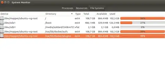

Or more visually:
That is, the other tools show that I have only about 800 Megabytes free. This is a drastic difference. Also, it stands to mention that the disk and the home folder are both encrypted. I encrypted them just by clicking 'yes' during Ubuntu installation.
